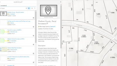

We don't use annotations, but searching for public anno layers, you can see other orgs who use them in web settings. Shoutout to Chatham County, NC for being the guinea pigs, and for having nice clear annos.
