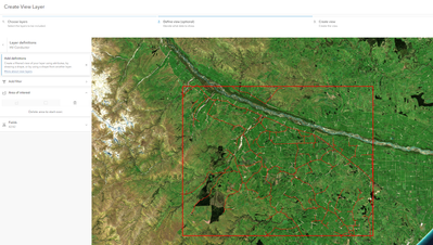

@AndrewHankinson - I am not aware of any way to set spatial filters on the Webmap. Its something that I think would be quite helpful. I have seen this floating around the ideas section but I don't believe that there is any progress.
While none of these may be ideal - there may be a workaround for you.
If you can create a view of the layer (not sure if you will if you are working with Living Atlas). In the creation wizard, you can define an "Area of Interest".
Another way you might be able to get past this by using the geoprocessing tools in the Webmap.

You are correct, I don't think that you can create a view layer using a layer from the Living Atlas. In the end I've just used ArcGIS Pro to create a new layer for my AOI. I was hoping to avoid doing this and just use some sort of styling or masking in AGOL. I think that you are right it would be useful to be able to do this.
