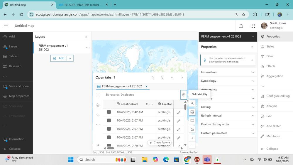

I am trying to reorder the fields in a table, I can turn off visual and reorder, but if I bounce out and back in, the order does not stay. In field view there is no option? I reordered in pop up and saved but it does not hold when I re-open the table? am I stuck with this order? I don't even think it holds the order when I re-order in PRO

nope, it changes the order while in this tab, but does not hold the change when I open in DATA mode, configure pop up doesn't work either. Maybe because it is coming from a Survery123 Connect? the data entry order is different than the final view order it is going into...

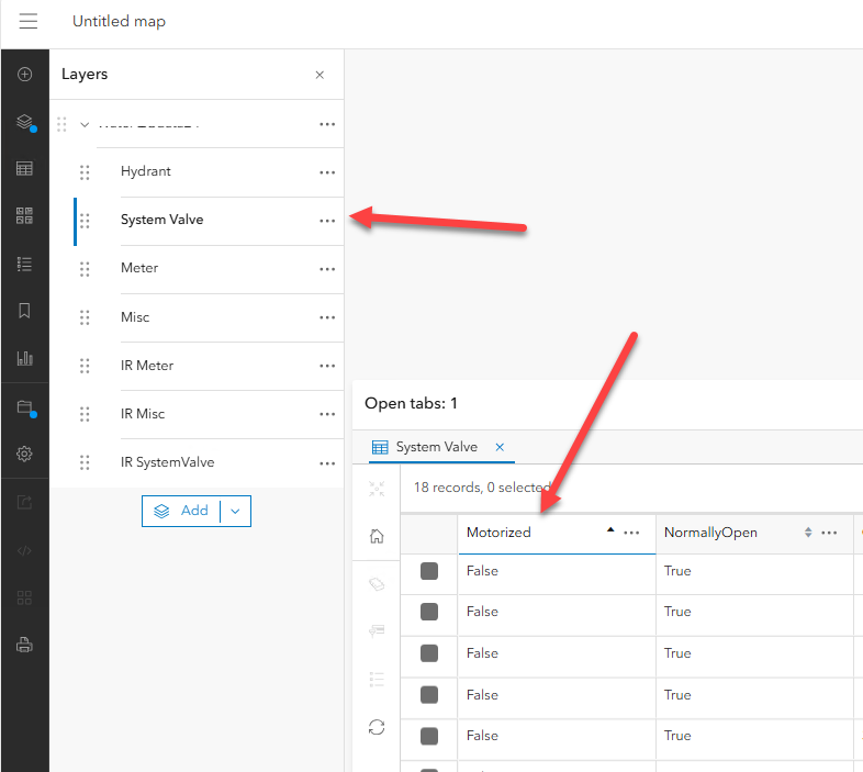

My Testing:

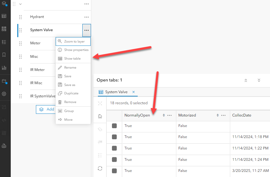

In the Data tab of item details, this example has NormallyOpen as the first field:
If we open that in New mapviewer and open the table for the System Valve layer we see that is the case:

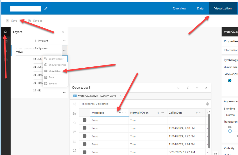

In Visualization tab of Item details, select Layers, then open the table of the FC you want to re-order, re-order them and be sure to click Save in upper left (I moved motorized to be the first field):

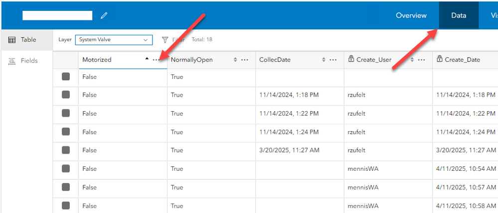

Now if we look at the Data Tab, you will see the new order of fields:
And if we add the data to a new MapViewer and open the table, you will see the new order:
RhettZufelt_12-1759943899757.pngSo, it 'should' maintain the order set in the Visualization tab unless overridden in a web map.

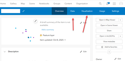

To set it at the data source level, you will need to open your contents page and navigate to the folder where the FERM engagement v1 251002 hosted feature service is located, click on the three dots to the right, and select View details.
In there you will see the Visualization and Data tabs in the upper right.
