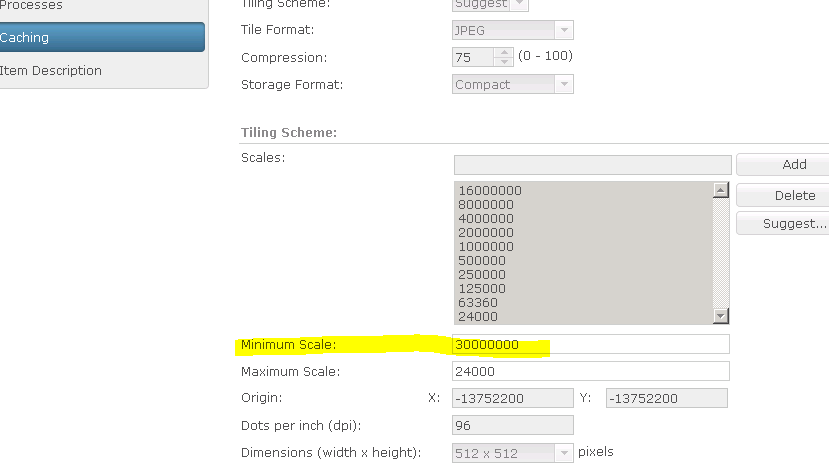

Jeff, I had a similar thing happen yesterday where my basemap/image would display at full scale, but when I tried to print, only operational layers would show.  For me, I had to go back to my basemap ArcGIS Server service and change the "minimum scale" in my case. I did this in ArcGIS Server Manager, selecting properties for the service I was having issues with.  This is a custom and cached/tiled  basemap, tiled from   1:16m to 1:24k.
In manager, I was allowed to change the "minimum scale" to 30m.   I saved and refreshed the service.  That seems to have fixed it for me.  I was not able to find this in Catalog (their it was "minimum cached scale" , not "minimum scale")
I'm not sure that this is the way it should work, but it did.  My guess is that since my cache was set to 1:16,000,000 and displayed correctly, when I when to print is was attempting to get different tile scale and was then blank.  For my immediate purposes of testing printing with custom templates and geopdf, that's what I needed.  I'll be messing with it more myself in the future.
