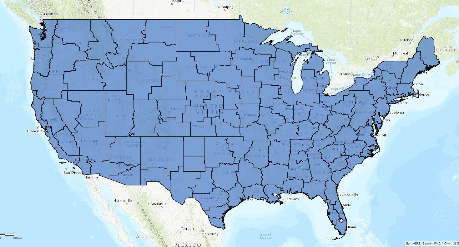

I uploaded a shapefile with these "CWA" polygons to AGOL and created a hosted feature layer.  The result looks something like this:

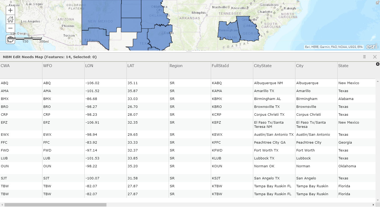

Here's the problem - the map does not update dynamically when somebody submits a new survey.
When I first perform the join analysis, the map does update based on any existing survey responses, but once I add a new response, the map does not update.
What's very odd is that when I review the details of my joined feature layer, the data table DOES SHOW the new data in the table.
Here is a screen shot showing the table:
However, when you view the table within the map details, you can see two entries for "TBW" (the bottom rows), and no entries for "MAF" (4 rows from bottom):
The other odd aspect of the map is that when I click on various rows, the domains that are highlighted on the map do not match the CWA value.  For instance, clicking on "TBW" should highlight an the blue shading around Tampa Bay, FL, but it instead highlights central Oklahoma.
Bottom line, there appears to be some syncing issue taking place and I would love some help .

Hi JJ, I think I figured it out - I hadn't been selecting the "Create results as hosted feature layer view" box before running the analysis. When I re-ran the analysis after doing that the resulting layer looks to be automatically updating as records as added to the related table.
