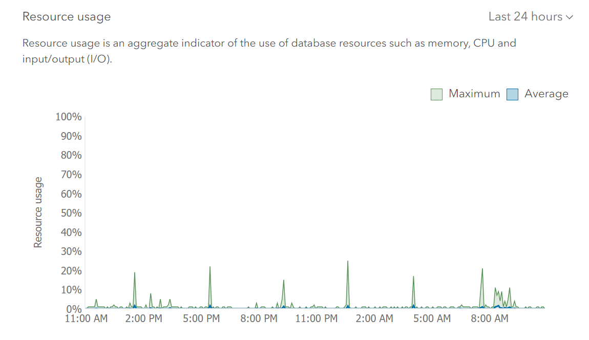

We have credits that are charged for storage, that part makes sense, but it's rare that our Feature Data Store is over 0%. I see spikes on the graph during activity, but then it will go back down to 0% quickly:
At 8am today, that makes sense because we were doing an activity on rendering data from CSV spreadsheets. But then it drops down to 0% again.
So this might be the duh question - what exactly does the Feature Data Store store? Data is obviously stored on AGOL, so is this just storing the data from processes at the time or during analysis (ie. like processes on a type of task manager) or is it something else?

However the screenshot you have shown indicates you have a Premium Data Store. This offers fixed feature storage pricing and dedicated resources. e.g. up to 1TB of feature storage without credit consumption.
https://doc.arcgis.com/en/arcgis-online/reference/faq.htm#anchor7
I know this as you only get the Resource usage chart when you have a premium data store for your ArcGIS Online organization. This chart is an aggregator of several metrics. Marianne Farretta and her team made some great updates to it last year. Read more about it here:
https://www.esri.com/arcgis-blog/products/arcgis-online/data-management/tracking-your-premium-featur...
So in short:
  • You appear have a premium data store that allows for some dedicated feature storage (Hosted Feature Layers mostly) without credit consumption.
  • You appear to be well within the resource usage limits of your organization e.g. volume of requests, CPU, other processing. No concerns here.

While it used to be the case that you could only view a resource usage chart for Premium Feature Data Stores, it was made available (October 2023 update?) for Standard Feature Data Stores as well.
One way to determine which you have is to look below the "Feature Data Store" link you clicked on to open the chart. It should indicated Standard or Premium, next to the storage used value.

Ah, I made the mistake of checking with a personal subscription which
doesn't have it
The advice still largely applies except the free storage part.
