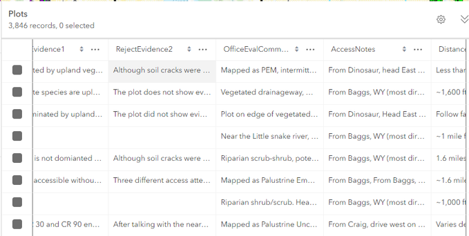

Surprised I cannot seem to find a post on this.
I am not seeing a way to wrap text in the attribute table of new map viewer?  We set the form to multiline but it does not seem to pick it up.  Not seeing any options under Fields button either.  You can see it on a mouse over but having to mouseover row by row is painful.

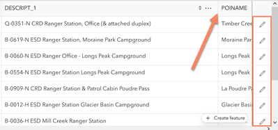

Hi @DougBrowning, you are correct. Currently you cannot "Wrap text" in the table. There are a few options you can explore to help with readability though. You can drag the column size to expand it or launch the record in the form using the editing column. The form should give you a better view of the record since it was set to multi line. Do submit an idea though and we will look into it! Thanks

Thanks but we for sure do not want them to open a form.  In fact we wish that the edit button (and create feature) could be hidden completely.  Most of our data comes in from 123 forms so if a user edits in the map then none of the 123 calcs fire.  Also clicking one by one would be painful.
