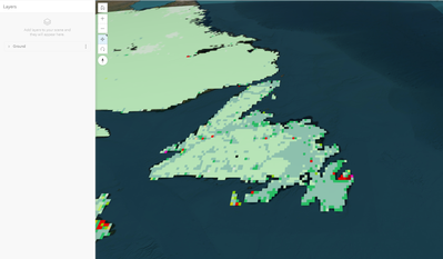

I believe you will need a tile layer as well to drive the tiling scheme of the scene if a basemap is present.
Quick example of a WMS and tile layer as a basemap in a web scene in Scene Viewer https://arcg.is/1qePX4
