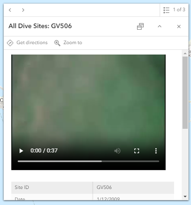

I've added a video to a popup using the code below, using the Arcade element. My feature has a field that contains the name of the file (and another saying if there's a video at the site). The video has to be accessible on the internet to be able to play.
var output
var url = theUrl
if ($feature.VideoExists == "Yes") {
  output = `<video controls>
    <source src="${url}${$feature.Video_ID}.mp4" type="video/mp4">
    Your browser does not support the video tag.
  </video>`
return {
	type : 'text',
	text : output //this property supports html tags
giving me this popup
