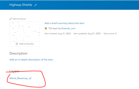

Hello,
I just created my own and I can open it from the new Tile layer page, but when I try adding to an actually existing web map it adds the whole World Basemap layer and not only the Shields. Do you know how I can only reference the Shields tile layer that was created? I tried adding yours too but it will only add the whole Work Basemap layer.

Kohl_Haessly
Thank you for the reply. I did open it in map viewer and was able to only see the Highway Shields, but when I try to add the service to an existing web map it adds the whole basemap and they are not separate? I may be doing something wrong, but I just cant figure it out.
