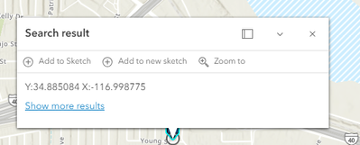

You can search for the coordinates and with the popup for the result add it to a new sketch layer or existing one.

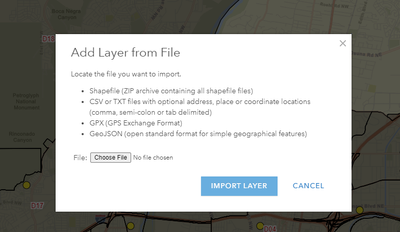

What is the file format you can get from your GPS units? both new and classic map viewer have the ability to add data from a file. Unless I am misunderstanding what you are trying to do this seems like it would be a better approach than inputting coordinate pairs manually.
