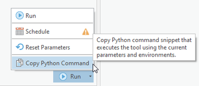

The documentation for Add Field contains a couple of examples of a script to add field to an Attribute table.
If you are new to python, fill in the GUI dialog for Add Field, then use the Run button's option to write the code for you
