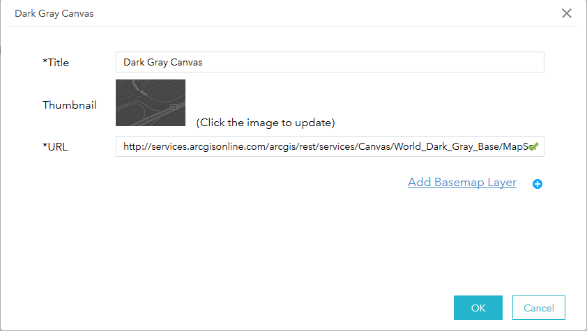

I am wondering if it is possible to add Esri vector basemap/tile layer to my Web AppBuilder basemap widget. I am using custom zoom scales and the precached basemaps wont work, however the vector basemaps do. Does the esri vector basemap group make the service url to these basemaps available similar to the default basemaps. For example if I wanted to add the Dark Grey Canvas basemap to the widget I would fill out the dialog box below and use the service url.
http://services.arcgisonline.com/arcgis/rest/services/Canvas/World_Dark_Gray_Base/MapServer

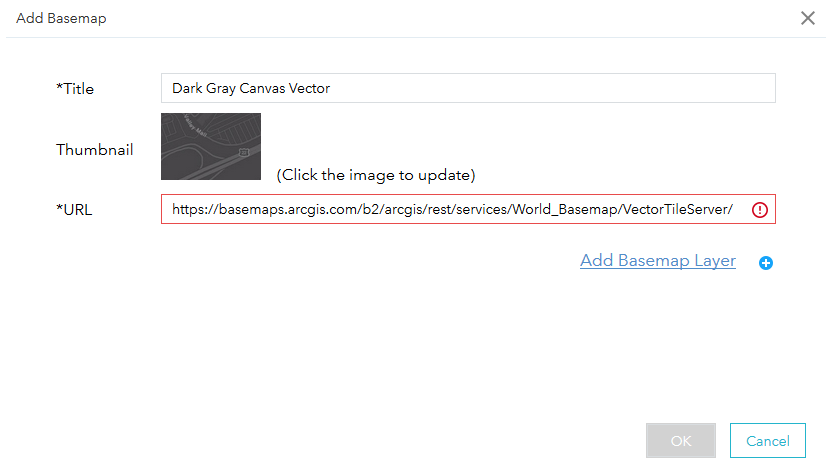

However I cant seem to find the service url for the vector tile maps the only url I see exposed is
https://basemaps.arcgis.com/b2/arcgis/rest/services/World_Basemap/VectorTileServer
but this link isn't accepted by the dialog box. Is there a service url for each vector basemap?

> The status of Esri BUG-000106317 - When adding Vector Tile Basemap in Web AppBuilder Basemap Widget an error "This type of layer cannot be used as a basemap." will appear. - that you have been associated with has been changed to Not in Current Product Plan.
Public Explanation: At this time the only supported vector basemaps in the WAB basemap widget are the Esri default basemaps.  If using a custom basemap it must be a raster, not vector, basemap.

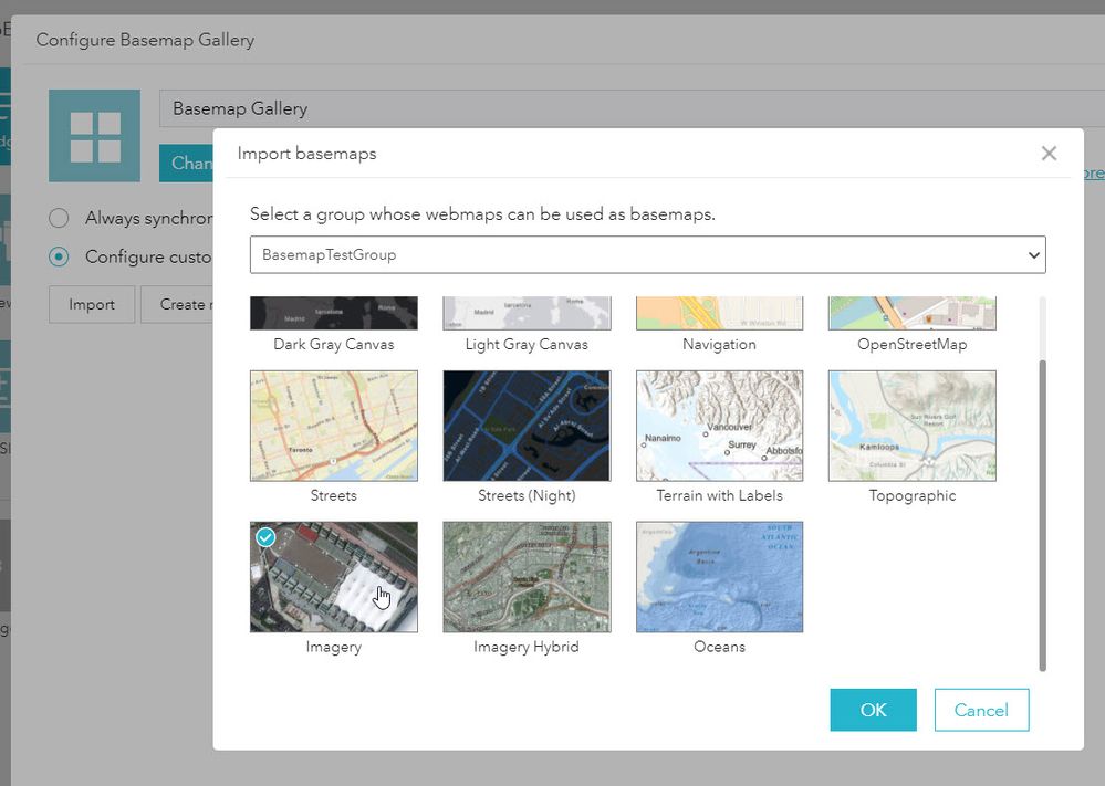

Hi @ElaineDeLeeuw ,
Are you able to add this tile layer into map view? You may try create a basemap with this vector layer, and set the basemap gallery property in your organization. This blog may help: https://www.esri.com/arcgis-blog/products/arcgis-online/mapping/custom-basemap-gallery/
Once you share/add your base map to the group you set for the Basemap Gallery, you can see it in WAB basemap widget. You may either sync with the basemap gallery setting or customize adding and reordering your target maps. 2020-11-12_14-15-09.jpg
