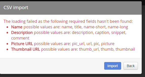

I am creating a story map and I saw the option for adding a CSV file which has all the data
however I got this error:
From this, I see that it is possible to add a field which will contain the photo for each point location? How can I do that inside a CSV file? Is it some sort of a link? The photos are stored in a folder in my computer.

As for the other fields that you received in error, the field names must match the expected field names (using the sample CSV file is a good idea and just keep the field names the same).

Your CSV file headers is clearly defined in the import error message you got and must look like this:
namedescriptionicon_colorlonglatpic_urlthumb_urlis_video
