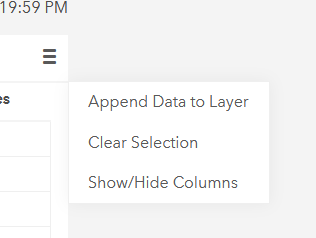

I am currently experiencing this. I am trying to add a field to a hosted Table. No relates, or parent layers, just a table. The table was not originally published with Survery123, but was then hooked into a Survey through Connect. I also have a View Layer established via an AGOL Join.
I'm an admin and the Table has editing enabled. I don't see the option I normally would to add a field directly in AGOL:
So I tried in Pro 2.7 and got Error 000852: Cannot add field <value> to <value>  which mentions read only data or lock issues, but neither of those apply.
