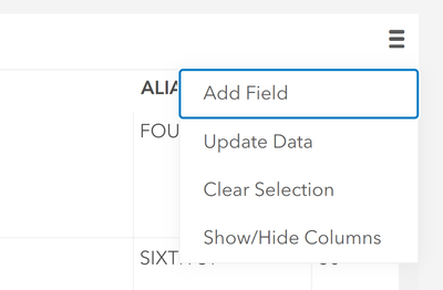

Are you clicking on the Menu, then trying to select "Add Field" from the options? I don't see an "Add Field" Button in the Data View of the Feature Service Item page.
BrandonA_CDPH
Thank you. That is the missing button/option. Some of my feature services have it there and as a standalone button on the fields view. 😊
