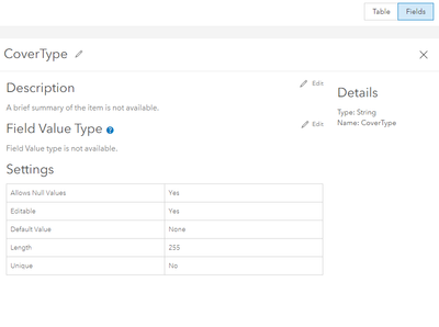

I need to add coded value domains to a hosted feature but the 'Create List' button is not available.  I am the owner of the layer and it is editable.  It was published from ArcPro without any domains associated with it.  Am I missing something simple?

Is your layer already symbolised by the field you are trying to create a list for? I just had a similar issue. Setting the symbology back to 'Show locations only' and then going back in to the Fields screen you have shown allowed me to create a list. You can then recreate your symbology based on your CoverType field.

No, the layer is symbolized by 'Show locations only' already.  I tried switching it to a different symbology type, saved it, checked the field settings, and still no Create List option.  I switched it back to 'Show locations only' and still no Create List option.  This issue is on all fields - the Create List option is not available for any of them.  Thanks for the suggestion though!  Got any other ideas?
