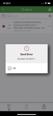

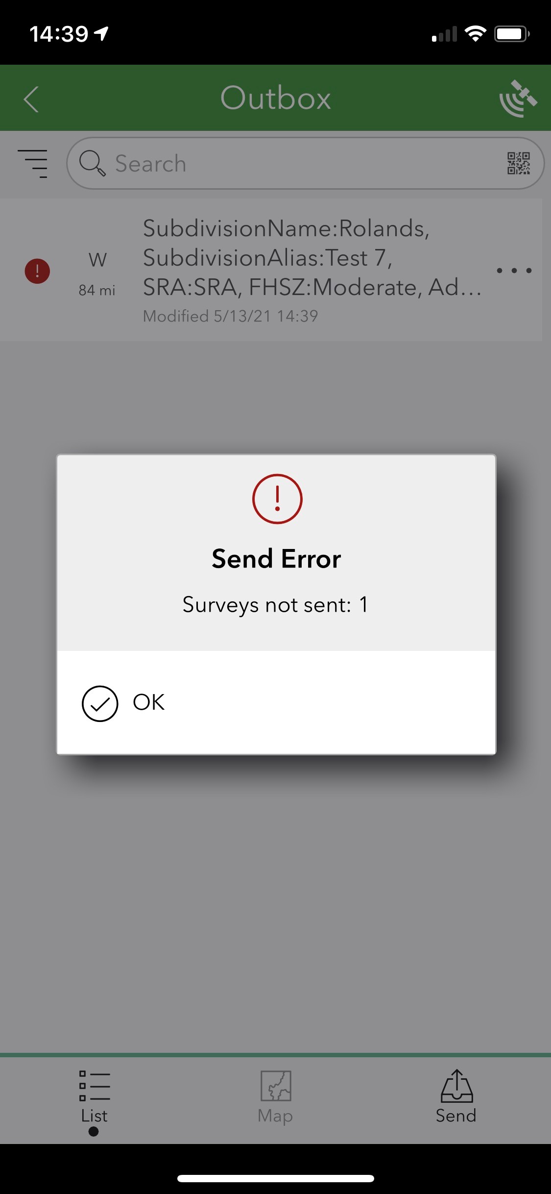

The symptoms: The feature service seems to have issues with being edited. With the feature service webhook active, the Survey123 mobile app shows a generic error when an update is submitted. However the data carries through.

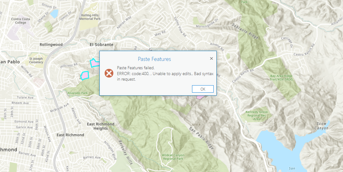

Certain editing operations are also having trouble for the feature service. I can make edits to existing features in the service (attributes, geometry, and can delete), but can't seem to add data en masse (which is critical to my workflow). If I try to copy features into the webook-active service, I get this:

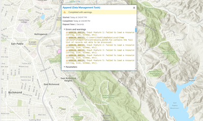

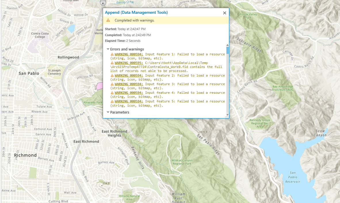

If if I try to append data into the service I get this:
The warning above deals with the XY domain. I played with every environment setting in the tool, same result. Stranger still: If I use either copy/paste or the append tool and I enable undo and discard the edits, the features still show. Sometimes it's the ghost of those features...they'll pop up at certain scales and not be selectable. Other times, and this happened when I was trouble shooting and re-running the tools several times, I would close the project or remove the feature service and all of the attempts would show up. There'd be 10 of the same feature stacked on top (even though I discarded the edits).
