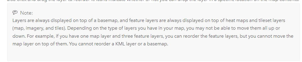

It would be nice to have a solution for this soon. ArcGIS Online restricts the options to move feature layers below a map service in a web map.
Specifically the issue for me is I am using an MTO feature server layer and I was it to draw and be shown under our municipal owned datasets Map server. So staff can view the MTO regulated assets if needed but they aren't the main focus, Since the municipal assets are the main focus I need a way to be able to move the MTO feature services to draw at the bottom and NOT at the top?

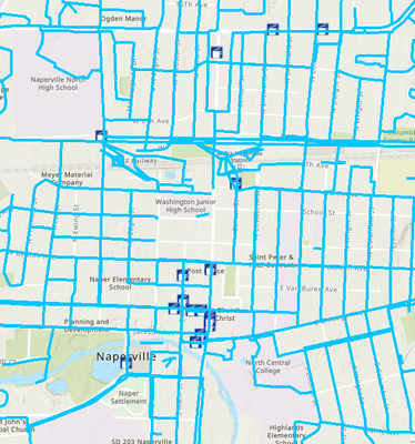

Map Viewer showing map image layer(roads) over a feature layer (coffee cup symbol)
