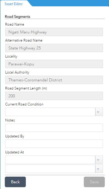

Currently the Web App is setup to use the "Smart Editor" widget, you click on the road segment to begin editing the attribute information:
What would be useful is to have the Updated At automatically populated with today's date and time.
