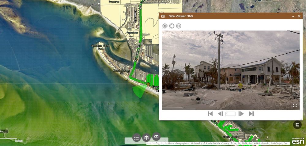

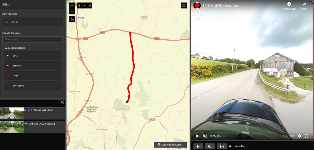

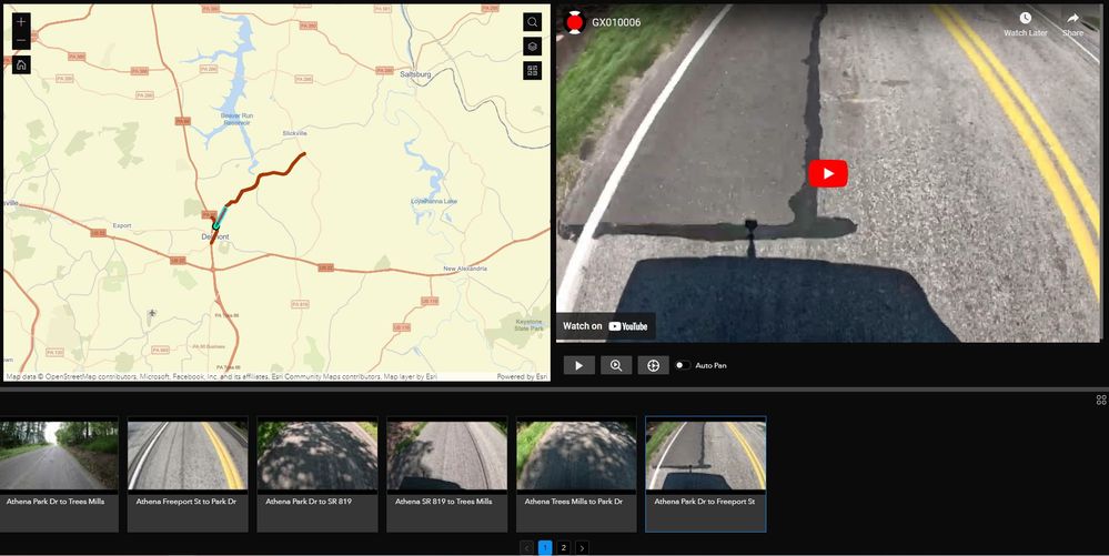

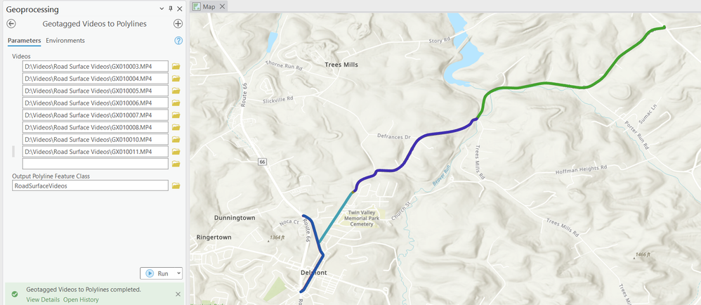

  2. GeoTube for ArcGISGeoTube road inspection.JPGElectric line inspection.JPG
