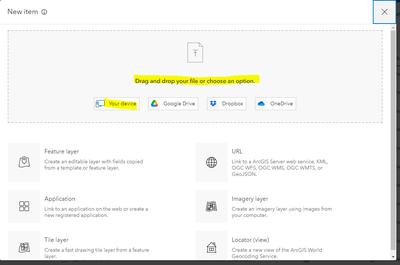

If your goal is to simply upload an image file and store it in ArcGIS Online, you can add any file on your device by dragging and dropping the file over the New Item dialog or clicking the option to upload from your device. You don't need to identify the file type beforehand. ArcGIS Online will identify it for you by its file extension, ask for clarification (e.g., what's in the ZIP file), or indicate file is not a supported type (e.g., 7z).

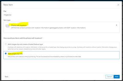

KirstenHazler
So to upload a zipped TIF, I learned by a colleague's trial and error that you have to specify "photos with locations", which is truly terrible wording. My raster is not a photo. Also, to me, "photos with locations" does not imply orthorectified imagery or any other kind of GIS raster, but rather, actual photos of things (like a plant or a tree or scenic view) that are tied to locations.
ESRI, please fix this wording to avoid confusion. Put "raster" in the drop-down menu.

After some investigation, you are right. Image Collection has been removed as an option when adding a ZIP file in ArcGIS Online in the most recent update. This type typically serves as the source data for publishing an imagery layer in the Enterprise version. Publishing from an image collection isn't supported in Online.
However, the options to add a ZIP file of this type has exist previously, and customers like you used this type to store a collection of images not intended to be used to create an image layer. As a workaround, you can alternatly identify your zip file as "Photos with location" and NOT choose the option to also create a hosted feature layer.
