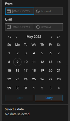

We have built a Vehicular Crash dashboard for our two county region, The crash data includes the time of day of a crash. Being able to select crashes that occurred within a given time period of the day such as early morning or night time is part of crash analysis. Date range is available but TOD is not.

I created a case with Esri support and they said the ability to filter records on a time of day range is not possible at this time.. For instance, how many crashes occurred between 5 am and 7 am for the five year record set?

Create a Web Map with a time slider and embed the Web Map in your Dashboard
Or configure the date selector to pick a range by day and time

Thank you Jansen for the Arcade suggestion and Robert for the Time Slider , I will review those. My dashboard currently has the built in Date selector which also includes the time variable however it filters date 1st, then time so the result is would like do not come out.
 As I mentioned, I wanted the user to be able to filter on early morning or night time crash history.
