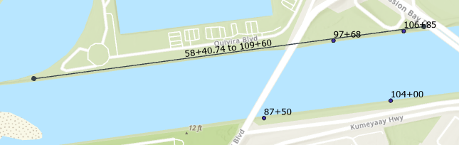

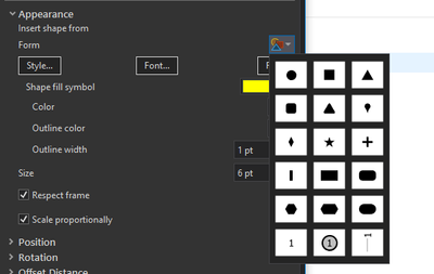

I'd love to see at least different line shapes added to the ArcGIS Javascript symbols. Right now only arrowheads are supported, but I really need circles. This would help me show consistent symbology for stationing when two stations are connected by a line feature.
Thank you for the consideration.
