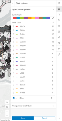

I would greatly appreciate the ability to use field values as symbology values, as is possible in ArcGIS Pro when checking the box for 'Allow symbol property connections.' In fact, I have a layer that uses this for color. It uses single symbol symbology, but each feature appears a different color since the hex code is stored in a table and set up to do so. When I go to publish online, though, not only does it not give any warning that this is not supported in AGO, but my features upload with a default gray appearance. The only workaround seems to be to manually set the color of each symbol class and to save that to the layer, which is still undesirable as it results in massive legends that aren't really necessary and manual labels for everything. Transparency by attribute is already an option, but there ought to be parity with Pro in this regard.

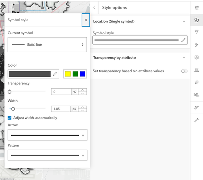

@RussRobertsthanks, where do you go to configure that? I only see the option to vary transparency:
RussRoberts
Sorry for the confusion- manually meant I did this one through ago-assistant and wrote out some web map JSON.
First published a web map from Pro with the option to use symbols compatible with all apps unchecked in the share web map dialog. Then I made the few changes to the primitive overrides that are written under the web map JSON to align with the CIM spec and what the JSAPI which handles the map view layer drawing expects.
