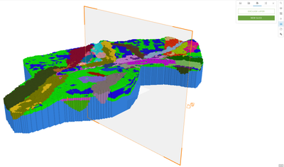

The Voxel Layers are a warm welcome and do indeed provide a feasable way of sharing geological subsurface models. Unfortunately though, analyze tools with the slice option does not work for the voxel model. Only the dem, overlays, features etc. are sliced. This is of course a bit disappointing as the whole purpose of showing the model is for the users to slice the model according to the area of interest combined with various GIS data like boreholes and seismic cross sections.
From what we can see in the What's New in Scene Viewer (March 2022), the Analyze tools in Scene Viewer are not available with voxel layers. Will this be a feature in the future?
