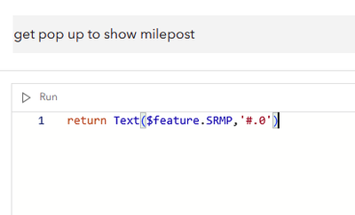

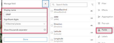

Here is an example of the steps I had to take to get the decimal places in one milepost layer to be consistent between the table, label and pop up windows in the new map viewer:
1. change the decimal place settings in the fields settings:

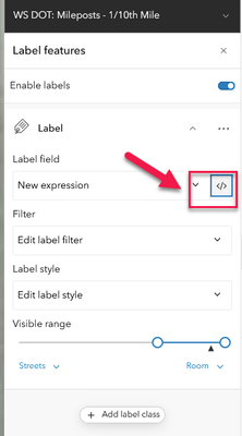

2. label pop up window: add custom arcade script:
apply custom arcade script for label:

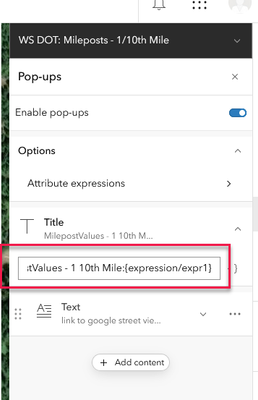

3. Create the exact same custom arcade script in the pop-up window settings:
apply this in the pop-up window settings:

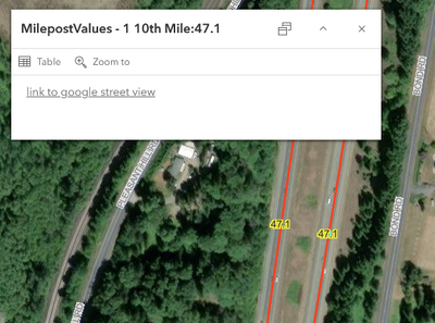

The result after repeating the same configuration steps 3 times:
