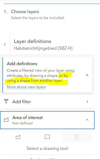

The tooltip in ArcGIS Online is also misleading stating "Create a filtered view of your layer using attributes, by drawing a shape or by using a shape from another layer". The latter is simply not implemented yet.
HollyTorpey_LSA
@PhilippeVDV I totally agree. Filtering my view using a shape from another layer is exactly what I need to do, but it doesn't seem to be possible even though it says you can do that right there on the page. Rather frustrating! I keep looking around hoping that I'm missing something...
