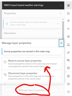

AndreasHall
I think this is partly implemented already. In the Properties tab in the map viewer, under Information, there is a Manage layer properties. When you click it you get the option to Reset to source layer properties. This option should allow the changes made in the Visualization tab to be reflected in each individual web map.

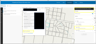

I wasn't aware of this option in AGOL. I tested it, and it seems to work as I envisioned. Here's the process I followed to test it:
  1. Create an Arcade Expression:
    • Set a new Arcade expression on the Property layer under the Virtualisation tab that returned the text 'Test V1'.
  2. Apply the Change in WebMap:

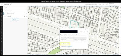

    • In the Planning WebMap, use the 'reset to source layer properties' option as you suggested. This brought the change across from the layer. (Which is great!)
  3. Create Another Arcade Expression:
    • Set another new expression on the Property layer under the Virtualisation tab that returned the text 'Test V2'. This new change automatically appeared in the Planning popup, exactly as I wanted which is fantastic.
  4. Moving Further:
    • Now, I just need to go to each of my WebMaps and ensure the 'reset to source layer properties' option is selected for my Property layer and any other layers I need centralized.
Property layer - Virtualisation tab:
Planning WebMap:
