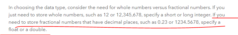

Hi Brad.  This idea isn't valid as currently presented because it's based on the assertion that integer field types can store decimals.  Please see ArcGIS field data types—Geodatabases | ArcGIS Desktop
If you set up the field types correctly in ArcGIS Pro (or ArcMap) and then publish, you should be able to enter the numbers needed in ArcGIS Online.
Hope this helps!
