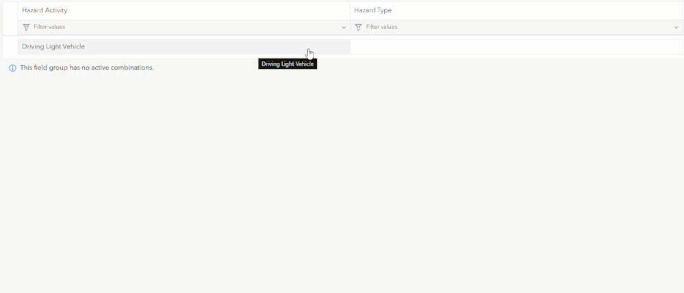

The new Contingent Values functionality looks good in ArcGIS Online, but the creation/management of the values seems a little cumbersome, in particular around the filtering and selecting of values.
IDEA: When you filter a list of values and click "Select All", it should only select all values from the filtered list (not the original complete list). Alternatively, add a second option to "Select Filtered".
USE CASE: When trying to see which values you have to work with, filtering may reduce the list you can interact with, but you still need to manually select each record you need when you may need all the filtered results.
P.S. I fail to see what the filtering is actually doing. Once I applied a filter, it still showed me all contingent values that had been created. You can see this in the below screenshot where I've filtered for Chemical Handling but still see a Driving Light Vehicle contingent value.
2 Comments
timcneil
Hi @LindsayRaabe_FPCWA ,
Thank you for the feedback! We will certainly take this into account as we work on this experience for future updates.
Filters are meant to operate and filter down the valid combinations you have saved for easier viewing of the different combinations you have. But, if you have a combination staged as a change (e.g., it is being updated, retired, deleted, or it is a new combination) the filter shouldn't operate on it. If you are seeing otherwise, this may be a bug? I'll try and see if I can reproduce the behaviour on one of my own datasets.
Thanks,
Taylor
LindsayRaabe_FPCWA
Ahhh - that might be part of the issue then. Because these weren't going to be implemented at the time (I was just testing how it all worked) none of my values were saved, so the filters wouldn't have acted on them in the way you have described.
