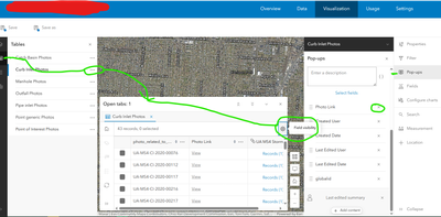

You should be able to turn off fields after it is published.
You go to the hosted service, navigate to the Visualization tab, and it opens something like a web map. Here, you can control what the public sees.
You can turn off fields in the table, and you can customize the pop-up tab.
Just make sure you save in the Upper Left Hand Corner.
jfisher
This functionality is essential. Why go through the trouble of maintaining relationships if they are not honored by the system? For now we are forced to propagate AND maintain our filter fields to every child layer and table, in order to apply the same filters. This means simple workflows, like the OP describes require complex behind the scenes processing. Also, for clarification, the above post does not address the OPs issue.
