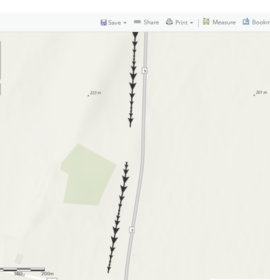

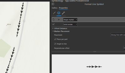

Well, I don´t have a data with m-values in, so I made a test with a line feature with 2-layers symbology, so I believe it´s similar settings as you have.
When I published to AGE (10.9.1 in my case  sorry don´t have 10.8.1 available for test) as a map service with registered data source
In the Map Viewer it works fine then....
Any difference in the settings on your side?

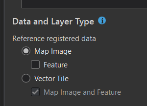

I apologize for the delayed response (vacation).  I found that I see the same behavior you see when publishing the service as a map service without feature access enabled.  However, if I enable feature access, the symbology is downgraded.  We would like this service to have feature access enabled, but for now we will stick with a map service in order to get the desired symbology.
