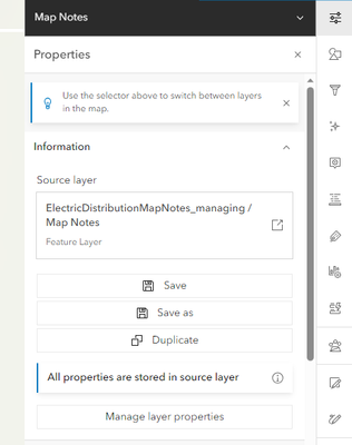

@marksm_macomb It is possible to save your smart form configurations to the layer. Use the Save option in Map Viewer to save layer configurations directly to the feature layer.
Saving Feature Layers in Map Viewer (esri.com)

@AlixVezina That's awesome! I was looking for this functionality in the feature layer overview/visualization/settings tabs so that's why I couldn't find it. Thank you!
