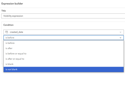

EmilyGeo
Hi @AlfredBaldenweck
this is an interesting case, thanks for bringing this to our attention.
One thing that could help for now would be to set Field B to only be visible when Field A contains a value. That could help with preventing Field B from calculating prematurely.
