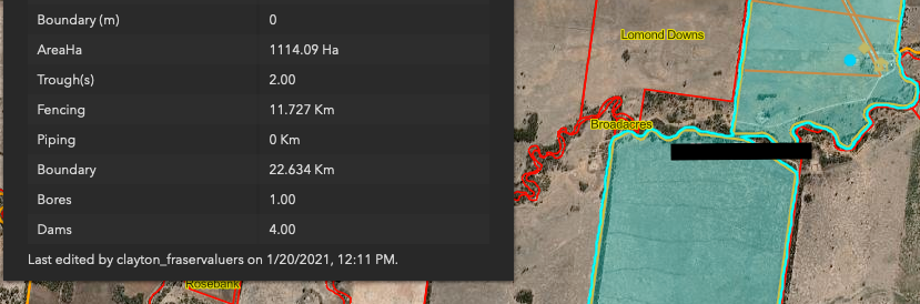

NikHenryOz
Hi,
I been using Acade functions within the popup design to display numbers of features within a polygon:
Popup detailsPopup details
So there is scope to use calculations using Arcade functions to display in a popup, this one is used to calculate the lattitude and longitude details for a point:
