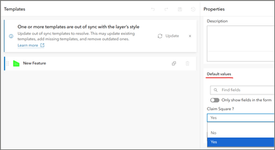

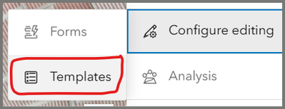

@Bud  - I have a simple hosted feature service that I was able to change the default value of a simple Yes/No question by editing the feature template.  Note I did not sync the template with the layer style and was able to save the new default value.  This idea still may be valid, if the desire is to use Arcade expressions to calculate default values, but I wanted to provide a potential workaround to help people in the meantime.

thanks for clarifying and for sharing your idea. You're right, the default value is not editable on the data tab. For now, the best workarounds are to configure templates and/or forms to set or calculate values for new features.
