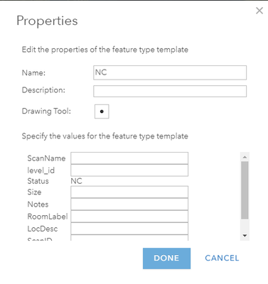

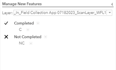

ColinKelly97
@Louis-PhilippeRodier How did you achieve this in map viewer classic? I want to make NC the default value of this layer called scan layer, specifically the Status field of the layer. I followed your instruction via map viewer classic and went into the properties but do not see an option to assign NC as a default value.

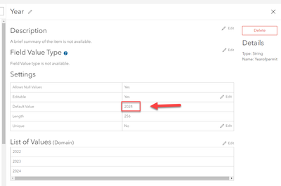

L77
I would also like to be able to change the default value just by clicking on a drop down menu in ArcGIS Online.
For my use case the default value is the current year, so it was 2023 and I needed to make it 2024.
As a work around I created a new year column in ArcGIS Online, pulled the hosted feature layer into ArcPro, field calculated over the values from the old year column to the new year column, then deleted the old year column. Next I set the default value to 2024.
Then I had to go into map viewer, web app builder and field maps and reconfigure the pop-up windows and filters to all use the new year column.
This took about an hour to make all of these changes and to check that everything was working. I also had our field staff remove their offline areas in field maps and re download them, so it took their time too.
It would be nice in 2025 to be able to just change the default value to 2025 using a drop down menu in the field settings screen. Then I wouldn't have to reconfigure all of my apps.
@ColinKelly97 , it seems that you are using the default value for you symbology, hence the non availability to change the default value. If you use display location only, you won't have that problem.

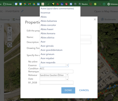

@L77, do you mean that the default is also the symbology? Cause if you have drop down menus in the feature layer, you should see the drop down menu in the default option.
L77
I am not using the year as the symbology. I am using the type and status as a two part symbology:
The year column is auto-populated so the worker doesn't have to enter it, I use the year field so they can filter by year in the web app builder app using the filter widget, and in field maps:
I am hoping in the future we can just change the default value here:
Is your screenshot from the symbology properties?
