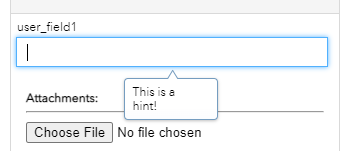

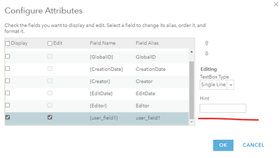

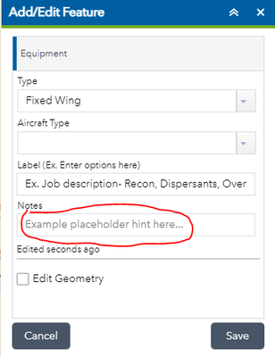

AlixVezina
@BamJam , for the Smart Editor and the Edit widgets in WAB, the best way to do something similar to a placeholder hint is to add a Hint for the field in the web map pop-up configuration (map viewer classic).
The hint will display in a tooltip when the field is in focus.
