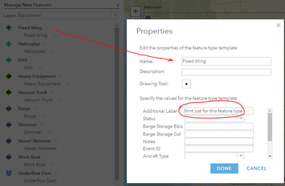

@AlixVezina Thank you for the quick response!  That is good, but it seems to apply to all the feature types for that layer when the user is attempting to add a new feature.  I have a feature template that defines several feature types that the user can select to add to the map.  The templates allow me to set default values for fields based on which feature type they choose, which is great. However, I would also like the hint to change based on the feature type that they select.
I was hoping I could use Arcade to dynamically change the hint based on the value of a field in the layer.  Is this something that is possible?

@BamJam This is not currently possible and has similar requirements as the original idea in this post. This would be good enhancement to be implemented in the new forms once they fully leverage arcade and potentially attribute rules. Auto-populate a permanent field based on Arcade Ex... - Esri Community
Also please note that this will not be available in the Smart Editor.

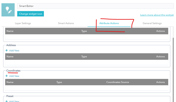

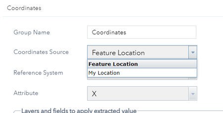

What geometry attributes are you attempting to calculate? The Smart Editor widget provides some automatic calculations that can also be triggered on feature update.

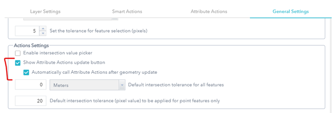

If you are looking for coordinates, setup a Coordinate attribute action. You can set it to use the feature's location or "My Location" (so the user's current device location) to populate these coordinates.
Then in the Action Settings, set the attribute actions to also update when the geometry of the feature is updated.
