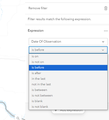

In Map Viewer it appears there is is no filter option for "within the current year". Our organization desperately need this (as I'm sure many others do as well). For some of our production projects we have filters set to the current year, and every year we have to manually go into these web maps and update the year/date in the filter.
Please consider adding a filter for "within the current year".
In addition, please note the difference in variety of filter options between Map Viewer and even ArcGIS Dashboards. Please consider filter equivalency between the two platforms:

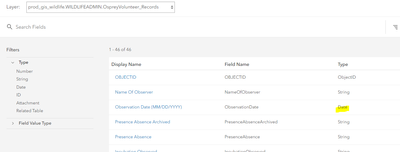

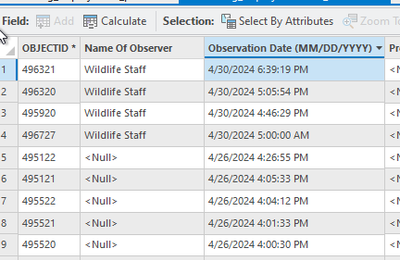

I did some digging and we're working with a federated Enterprise service (coming from our SDE). At the SDE level this field is labeled as a "date" field but is "date-time" field
In the service, the field is defined as a "Date" type also:
If I'm understanding correctly, when you refer to "date-time" that should be referring to the field type that we're using (defined at the SDE level), correct? If so, is there a reason we are unable to see the options you're suggesting we should see?

Update- Tested this workflow on an AGOL hosted feature layer as well (cut of the data) and we able to see the additional expression options.
Unfortunately "in the last" still isn't quite what we're looking for thought. We're looking for "In the Current"  such as current Year, current Month, or Current Day.
