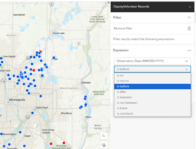

In Map Viewer it appears there is is no filter option for "within the current year". Our organization desperately need this (as I'm sure many others do as well). For some of our production projects we have filters set to the current year, and every year we have to manually go into these web maps and update the year/date in the filter.
Please consider adding a filter for "within the current year".

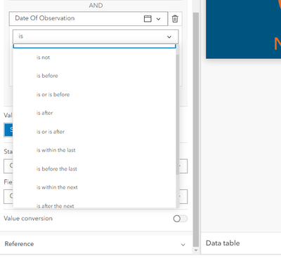

In addition, please note the difference in variety of filter options between Map Viewer and even ArcGIS Dashboards. Please consider filter equivalency between the two platforms:
