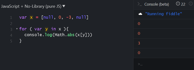

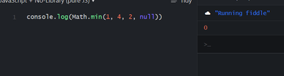

Bud
I wonder if it’s consistent with JavaScript, or if Esri diverged and did it their own way?
