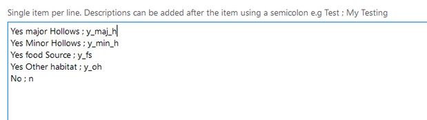

It would be much more easier to use a bulk import widget on the feature service in the List of Values (Domain) section. It could be similar to the screenshot below.

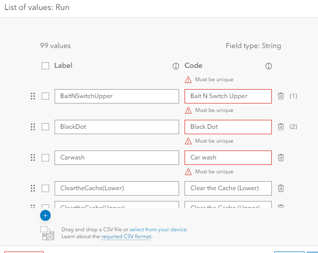

I have a list that seems to grow, but I do want to use Domains. I am using 123connect (Which works well for sorting). But when I need to update my Table, it can be confusing to try and sort through previous lists to see what I need to add.
Using your method via FMD above, if I 'REPLACE' will the old data still associate with the coded value? I am including a picture of adding NEW, and am getting a warning for duplicates. The number of entries associated with both entries is the same, so I think it will work, just want to make sure I will not lose data.
DougSims_GT
That error is saying that you have those values in the list more than once. Scroll down and see if they show up again near the bottom. If so, remove the second version of them.
One other note, it looks like you have your label and code columns switched.
Last, did you mean you "do NOT want to use a domain"?
