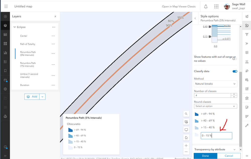

Hi @kate_sightline , we have an internal issue to implement being able to use arcade expressions in the Legend.  At the moment however, unless I misunderstood the question, I think you can do what you want to in the AGOL interface.  If you go to the style options for the layer in question you should be able to click on and modify any of the class labels.
