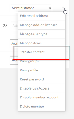

Can anybody tested the new "Transfer Content" tool and does this resolve this problem?
NinaRihn
Transfer content does work, but only if you want to transfer ALL of the user's content.  Transfer content doesn't allow you to pick and choose what to transfer.   Often we just want to transfer a certain project to someone else; not all of their content.
tiztrain
Yep just did some test and confirmed it worked for 1882 items though you have to first:
  1. Make sure you are added into every group that your transferring items from
  2. Make sure that there are at least 2 people in your organization that are setup as admins for MFA
