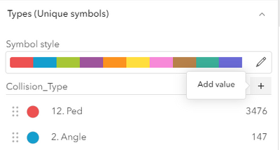

Opening the Types smart mapping panel you will see this new '+' button

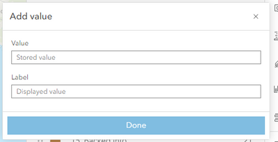

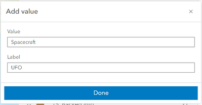

Clicking that will open this modal where you set the stored value and display value. The display will autogenerate to the stored but you can edit that.
Then it will appear at the bottom of the list above the 'Other' section

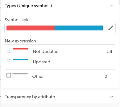

Dragging the newly added value into the 'Other' section will remove it from the list entirely if no features contain that value.
