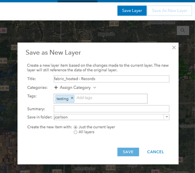

If I open the Visualization tab of a layer, I can adjust the symbology / filter / etc., however I like, then click "Save as New Layer", I can save my own reference to it.
This does not permit the kinds of view settings like exposing different sets of fields or using areas of interest, but it is a way that other users can own a reference to a source layer that is then styled and configured however they need it.
DataOfficer
Thank you I will check that workflow out. I didn't realise that would maintain the reference to the original layer which is useful.
