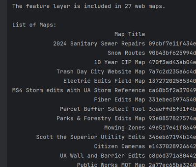

I have seen a lot of people asking if there is a way to see how many maps a layer is in. As an administrator, there is definitely some frustration in deleting layers and then finding out you didn't replace it in all of the maps. I think this script is a step in the right direction but it is not perfect, I receive a InsecureRequestWarning and Adding Certificate verification is strongly advised with the webmaps names under the warning

Here is a partial screenshot out the printed message:
