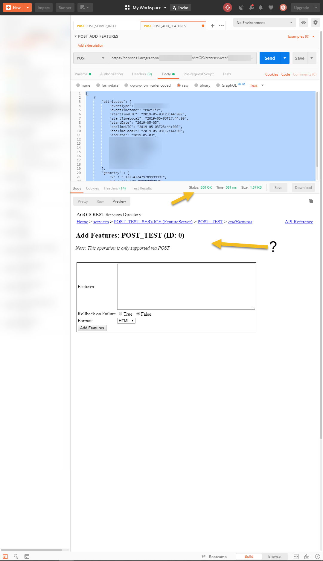

I'm unable to `addFeatures` to a Feature Service Layer using POST request. The "Add Features" website HTML shows up in my Postman response, not the anticipated:
{   "addResults" : [     {       "objectId" : 5,        "uniqueId" : 5,        "globalId" : "11239506-93E4-4B438-93A-47F4A338A",        "success" : true     }   ] }
In PostMan:
- METHOD: POST
- URL: https://services1.arcgis.com/<fsl name>/ArcGIS/rest/services/<name>/FeatureServer/0/addFeatures?token=<my token>
- POST REQUEST BODY:
 "attributes": {
 "eventType": "thing",
 "eventTimezone": "Pacific",
 "startTimeUTC": "2019-05-03T23:44:00Z",
 "startTimeLocal": "2019-05-03T17:44:00",
 "startDate": "2019-05-03",
 "endTimeUTC": "2019-05-03T23:44:00Z",
 "endTimeLocal": "2019-05-03T17:44:00",
 "endDate": "2019-05-03"
 "geometry" : {
 "x" : "-122.412479789999991",
 "y" : "37.770630098000083"
- RESPONSE: The actual HTML for the Add Features website!!
Can anyone see what I'm missing?

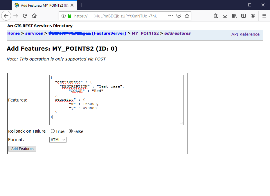

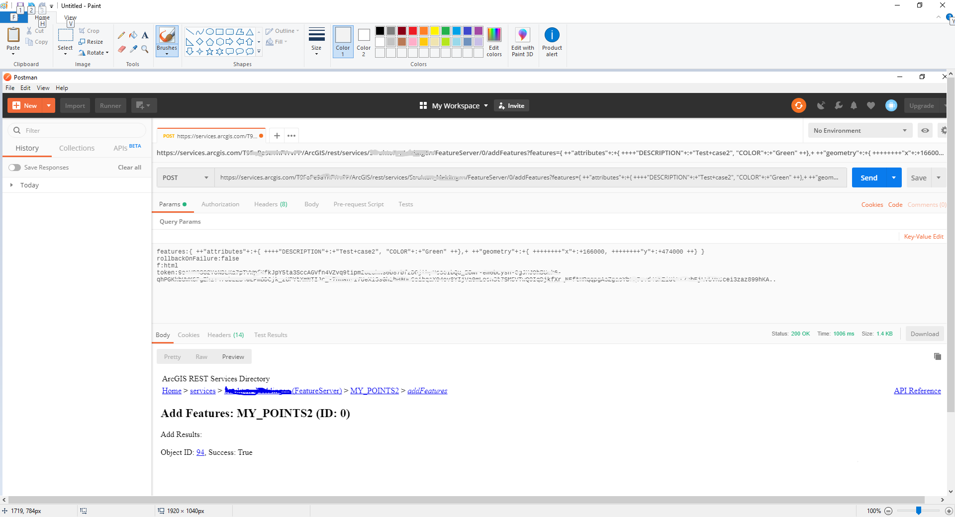

You can add a feature using the ArcGIS REST Services Directory (see screen capture 1) or using Postman (see screen capture 2).
In Postman the Query Params should be:
features:{ ++"attributes"+:+{ ++++"DESCRIPTION"+:+"Test+case2", "COLOR"+:+"Green" ++},+ ++"geometry"+:+{ ++++++++"x"+:+166000, ++++++++"y"+:+474000 ++} }
rollbackOnFailure:false
f:html
token:<a_valid_token>‍‍‍‍‍‍‍‍
This will result in a successfully added feature.

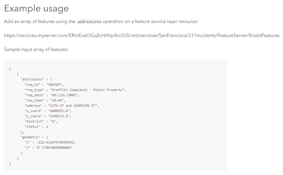

In the documentation you are pointing at (Add Features—ArcGIS REST API: Services Directory | ArcGIS for Developers) I did find the specification of the JSON to add a point feature.
Then I used that JSON in the ArcGIS REST Services Directory to add my test case and with the Firefox Developer Tools (F12) I did obtain the parameters of the URL to replicate the process in Postman.

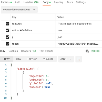

kris
I am also unable to post using json in the body. However, I am able to post if doing the same as ESRI does from the web page (urlencoded form body)
